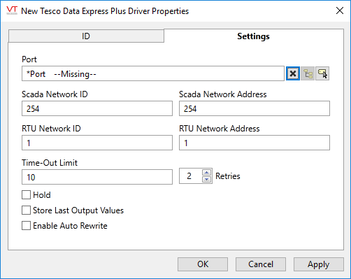

The Settings tab includes the following properties:
Port
Select the Serial or TCP/IP tag that will provide the address and port to be used when communicating with the RTU.
Scada Network ID
The network ID of VTScada. This will be used as the source network for outgoing messages, and must be the destination network for incoming message
Scada Network Address
The node address of VTScada. This will be used as the source node address for outgoing messages, and must be the destination address for incoming message.
RTU Network ID
The network ID of the RTU. This will be used as the destination network for outgoing messages, and must be the source network for incoming message.
RTU Network Address
The node address of the RTU. This will be used as the destination node address for outgoing messages, and must be the source address for incoming message.
Any incoming messages that are not addressed to the correct Network ID / Node Address (Scada) and from the correct Network ID / Node Address (RTU) will be discarded.
Time-Out Limit
The length of time, in seconds, that the driver should wait for a reply from the devic
Retries
Hold
Store Last Output Values
Enable Auto Rewrite
