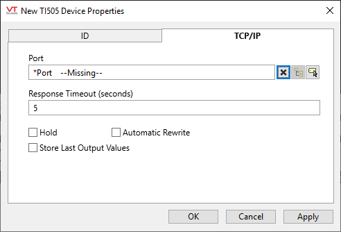

TI505 Driver properties TCP/IP tab
The following properties are configured in the TCP/IP tab:
Port
Select the TCP/IP tag through which this device will communicate. Note that only TCP/IP ports will work. The TI505 device driver cannot be used with Serial ports.
Response Timeout (seconds)
The number of seconds to wait for a response before raising an error.
Hold
Store Last Output Values
Flag indicating that the last values written to the device should be maintained. If true, the driver will maintain the last values written for each address, allowing these value to either be re-written manually or automatically.
Automatic Rewrites
Flag indicating the driver should automatically rewrite the last value written to each address upon successful establishment of communications after a driver error occurred.
