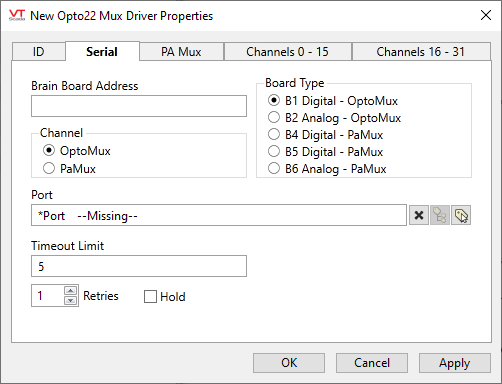

Opto 22 Mux properties, Serial tab
Brain Board Address
The brain board address.
Board Type
Choices as shown.
Channel
Choices as indicated.
Port
Select the serial port tag used to access the physical Opto 22 device.
Retries
Hold
Time-Out Limit
Set the receiver time-out limit in seconds or fractions of a second. This is the length of time that this driver should wait for a reply from the PLC or RTU.

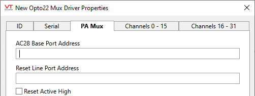

Opto 22 Mux properties, PA Mux tab
AC28 Base Port Address
AC28 adapter card base address. Only required for Pamux protocol
Reset Line Port Address
Port address for Pamux reset port. Only required for Pamux protocol.
Reset Active High
If set the brain board reset is active high. Only required for Pamux protocol.

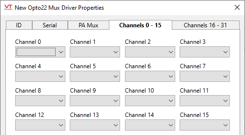

Opto 22 Mux properties, Channels 0 - 15 tab
This tab allows for the configuration of the individual channels of the Opto 22 device, 0 through 15.
Channel x:
This is configuration of the individual channels of the Opto 22 device. Options include:
- None = No module present
- DO = Digital Output
- DI = Digital Input
- AI = Analog Input
- AO = Analog Output
- ICTD = ICTD Probe AD4 Module
- RTD 10 = 10 Ohm RTD AD14T Module
- RTD 100 = 100 Ohm RTD AD10T Module
- TC-J = Type J Thermocouple AD5/AD5T Module
- TC-K = Type K Thermocouple AD8/AD8T Module
- TC-R = Type R Thermocouple AD17T Module
- TC-S = Type S Thermocouple AD17T Module
- TC-T = Type T Thermocouple AD18T Module
- TC-E = Type E Thermocouple AD19T Module
