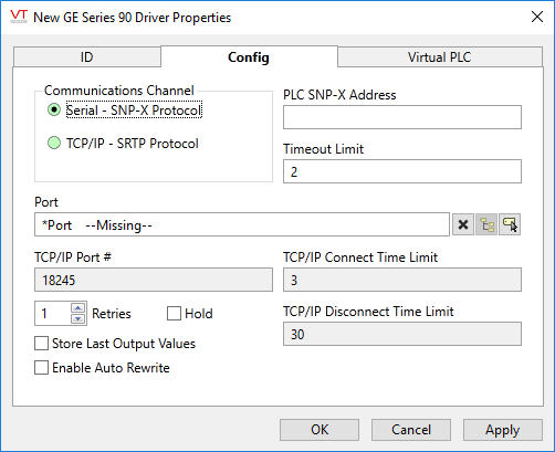

GE Series 90 Driver properties Config tab
Set the communication properties of the driver with the following fields:
Communications Channel
Sets the type of communication the driver will use to communicate with the PLC and can be set to TCP/IP (SRTP) or Serial (SNP-X).
PLC SNP Address/PLC or TCP/IP Address
If TCP/IP communications are being used, this will be the IP address of the PLC. If Serial communications are being used this will be the station SNP-X ID.
Timeout Limit
The maximum time to wait (in seconds) for a response from the remote device before retrying or generating an error.
Port
Select the external serial port for use with the SNP-X protocol. Note that the Port may need to be a Serial Port tag if the PLC does not support "Break-Free Operation". In it's original format, SNP-X protocol relies on the use of serial break commands that cannot be handled by TCP/IP or UDP/IP port connections to Ethernet to serial devices. Some of these devices may support the serial break function, but only if used with their supplied serial port redirector drivers and configured as a serial port in VTScada. Check the device hardware / software specifications to confirm if the break function is supported.
If the PLC supports "Break-Free Operation" and it is enabled, then a TCP/IP Port tag or UDP/IP Port may be used when communicating to the PLC using an Ethernet to serial converter.
A port tag does not need to be defined when using the STRP protocol as the driver uses an internal TCP/IP port
TCP/IP Port #
The TCP port number used by the internal TCP/IP port for the SRTP protocol.
TCP/IP Connect Time Limit
The time limit for a successful TCP/IP connection before an error is generated.
Retries
Hold
Store Last Output Values
Enable Auto Rewrite

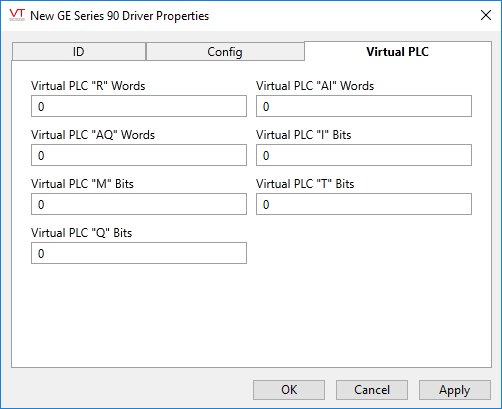

GE Series 90 Driver properties Virtual PLC tab
The Virtual PLC tab is for setting up the driver to act like a "virtual" PLC. Specify how many memory addresses of each type to allocate to this virtual PLC.
Virtual PLC "R" Words
The number of type "R" words to allocate for the virtual PLC.
Virtual PLC "AI" Words
The number of type "AI" words to allocate for the virtual PLC.
Virtual PLC "AQ" Words
The number of type "AQ" words to allocate for the virtual PLC.
Virtual PLC "I" Bits
The number of type "I" bits to allocate for the virtual PLC.
Virtual PLC "M" Bits
The number of type "M" bits to allocate for the virtual PLC.
Virtual PLC "T" Bits
The number of type "T" bits to allocate for the virtual PLC.
Virtual PLC "Q" Bits
The number of type "Q" bits to allocate for the virtual PLC.
