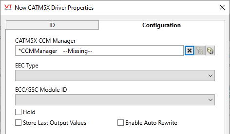

CAT M5X Driver properties: Configuration tab
CCM Manager Tag
CCM Manager tag that is configured for the CCM the ECC or GSC is connected to.
Controller Type
The type of controller you wish to gather data from, EMCP, 3400 or 3500. The controller type determines the parameter IDs available to read and write.
ECC/GSC Module ID
The module ID depends on the type of controller you have selected. The valid range for each controller is available in the drop down list.
| Controller Type | Valid Module IDs |
| EMCP | 88, 89, 90, 91, 92, 93, 94, 95 |
| 3400 | 33, 34, 36 |
| 3500 | 33, 34, 35, 36, 37, 38, 40, 41 |
Hold
Store Last Output Values
Enable Auto Rewrite
