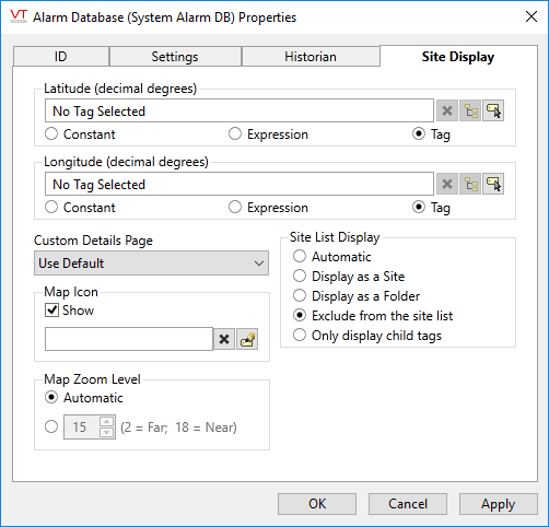

Alarm Database properties Site Display tab

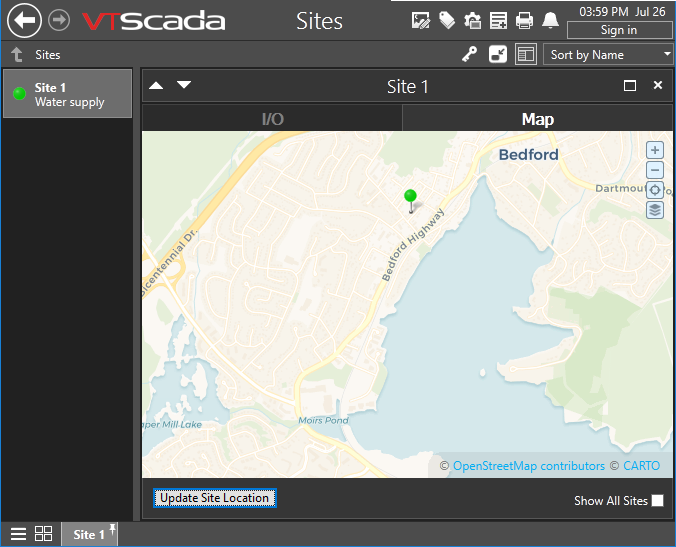

There are two ways to prevent a site's location pin from being shown on a map: Leave the Latitude and Longitude values empty, or deselect the Show option for the map icon. If the site has latitude and longitude values, but the icon is not displayed, then the indicator beacon will pulse while the cursor is held over the site's coordinates on the map, even though the pin is not displayed.
Holds location coordinates for this tag, thereby allowing it to be represented on a Site Map page if the map icon is shown.
Custom Details Page
If a custom details page has been created for this context tag, then that page should be selected here. If there is no custom details page, then operators will see the standard Site Details page upon clicking the pin for this tag in a Site Map.
Map Icon
You might choose to define a location for this site, but not display it on a map.
If a custom map icon widget has been defined, you can select it here. That icon will then be used instead of the standard icon when this tag is represented on a Site Map page. If there is no custom map icon, then the standard widget will be used. A custom map icon is any tag-widget that can be linked to this tag type.
This tag will be included in the list of a Sites page. What will happen when an operator clicks on this tag in that list depends on the Site List display choice, and on whether any of this tag's children are I/O tags. Note that the following applies only to the list section of the Sites page, not to the map.
- Display as Site: A click will open the Site Details page as a pop-up.
- Display as Folder: A click will leave focus on the Sites page, but the list will now show the child tags of this site.
- Exclude from Site List: This tag should not be shown in the list section of the Sites page.
- Only Display Child Tags: This tag is used to group other sites. Those sites should be displayed, but this one should not be displayed. Operators will not need to navigate through this site to reach the child sites.
- Automatic: If this tag contains child sites, folder display will be used. Otherwise, site display will be used.
Map Zoom Level
If Automatic is chosen (the default) then when a map is opened, showing only this site, it will zoom to level 15, which shows only the immediate surroundings. You may select any value between 18 (the closest possible level) and 2 (showing the entire globe).
Default zoom level.
