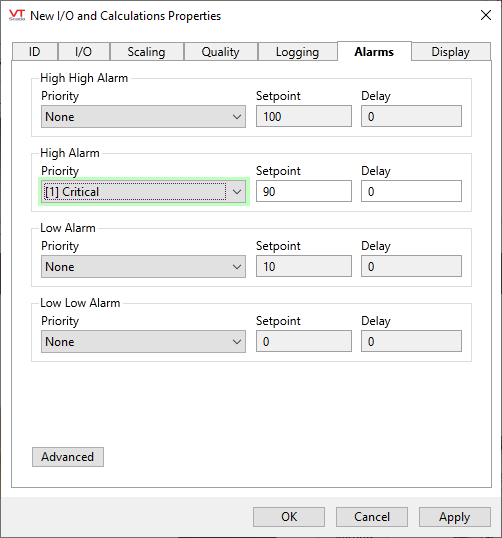

Analog Status tags - alarms tab
High alarm within an
I/O tag in analog mode

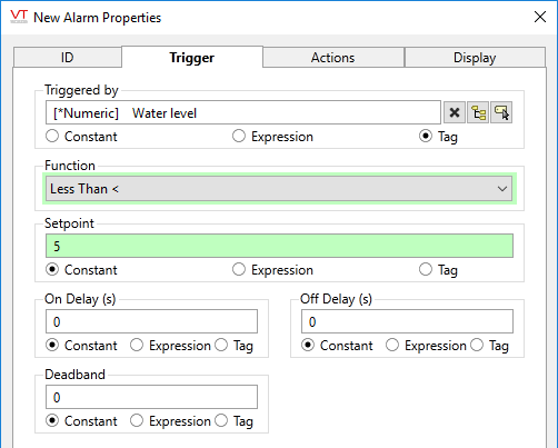

Alarm tag - Trigger tab
Built-in alarm configuration is always the easiest to configure and in most cases all that you would need. The separate Alarm tag provides the most control over all aspects of alarm configuration.

Alarm Trigger
An alarm on an analog tag is triggered by defining a high or low setpoint. When the value reaches or passes the setpoint, the alarm triggers and is said to be in an active state. An alarm on a digital tag is triggered by a given state, activating when the equipment enters that state, whether On or Off, Running or Stopped.
The setpoint can be predefined in the alarm, but it is always possible to configure operator or automatic control over the setpoint.
You might need to avoid nuisance alarms. Use either of:
  • Deadband - allows you to specify a range, within which the alarm will remain active if the triggering value retreats from the setpoint.
    The purpose of this feature is to prevent system noise from repeatedly triggering alarms or cluttering the record with repeating events. For example, a high alarm with a setpoint of 80 and a deadband of 2 will trigger when the value reaches 80, and remain in the active state so long as the value is above 78. Without the deadband, if the value hovered above and below 80, then each time it crossed the setpoint a new "active" or "normalized" record would be recorded.
  • Delay - allows you to ignore a brief spike in value.
    If you set an "on" delay, measured in seconds, the value must remain at or beyond the setpoint for that length of time before an alarm is triggered.
    An "off" delay is the reverse, used to prevent the alarm from returning to the normal state if the trigger briefly drops below the high setpoint or rises above the low setpoint.
    For alarms built into other tags, the only available delay is "On". Create a separate Alarm tag if you need an "Off" delay.
Alarm Priority and Action

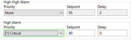

For alarms built into tags, setting the priority is the step that creates the alarm. While the priority is set to "None", the alarm does not exist.
This tag has a High Alarm. It does not have a High High alarm.
Some developers, working under the idea of "just in case we need it later" have set alarm priorities but also selected the "disabled" option in the advanced mode. It is far easier on system resources to simply leave the priority as None until the alarm is needed.

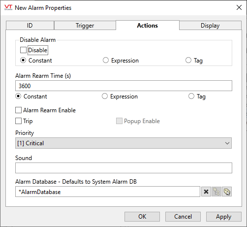

There are five priorities defined by five Alarm Priority Tags, which are included in every VTScada application. These control how the alarm looks and sounds (the "actions"). Using the advanced mode of a built-in alarm, or the Actions tab of an Alarm tag, you can override the some of the default actions from the priority and can add others such as enabling pop-ups or rearming.
Alarm tag - Actions tab
Features here include:
  • The ability to disable an alarm. This is sometimes tied to a digital status tag so that operators can switch alarms off during maintenance, or when related systems are not running.
  • A rearm time. When enabled, the alarm will return to the unacknowledged state after a given length of time if the triggering condition remains active.
  • Trip – For digital triggers only.
  • The name of a .WAV file may be provided in the sound field if you would like a customized alarm sound such as phasers firing or a warning of a warp core breach. (The file should be located in the application folder.)
