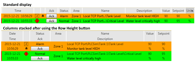

 - Each list definition within each ListFormat will contain two versions, Single and Double. This selection is controlled by the operator by toggling the Row Height option.

For each list, History, Active, etc. two sets of column formats are defined. Two are required so that the operator may use the Row Height button to switch between a list with one item per column and a list with (in some cases) two.
