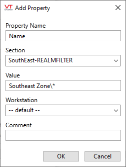

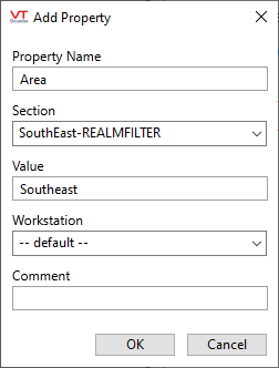

[RealmName-REALMFILTER] Section
The Settings.Dynamic [RealmName-REALMFILTER] section holds the list of tag areas or tag names (and their alarms) that should be visible when a user in a given security-realm is signed in.
To specify the visible tags:
- Open your Application Configuration dialog.
- Select the Edit Properties page.
- Select the Advanced Mode.
- Select Add.
- Complete the dialog as shown.
(Area filter shown on the left, tag filter shown on the right.)
- Select OK
- Repeat for as many tag names as you require.
You may use the asterisk (*) wildcard character as any part of the Value, but for best results you are advised to restrict wildcards to the beginning or end of the tag names.
For each subsequent Name or Area property in the same section, you will be warned that the property already exists. Proceed anyway.

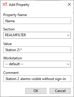

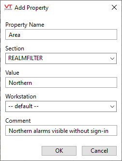

[REALMFILTER] Section
The [REALMFILTER] section of Settings.Dynamic is used only if you want to define the alarm areas that should be visible when no user is logged on. This is typically used if there is an Alarm List drawn on the default page because the Alarms page will not be accessible when no user is signed in. (See also, RealmAreasExcludeInvalid which controls whether tags that do not have any area defined will be included or excluded from view.)
To create a REALMFILTER section:
- Select Add.
- Complete the dialog as shown on the left to filter on tag Area properties.
Complete the dialog as shown on the right to filter on named tags. Note the \* in the value, which includes child tags of Station 2.
- Select OK
- Repeat for as many areas and tags as you require.
For each subsequent area, you will be warned that the property already exists. Proceed anyway.

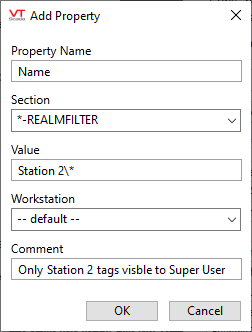

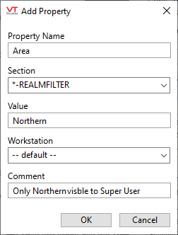

[*-REALMFILTER] Section
This optional section is used to restrict the tag areas that should be visible when a super user is logged on. (A super user is one who does not belong to any realm.) If you do not provide a [*-REALMFILTER] section, the super user can see all areas. If you do provide the section, then they can see only the areas specified in that section.
(The [*-REALMFILTER] section has no relation to the RootNamespace property. There is no realm named "*" for your super users to be a member of.)
To specify the tag areas that should be visible when a super user is logged on:
- Select Add.
- Select OK
- Repeat for as many areas or tag hierarchies as you require.
You may use the asterisk (*) wildcard character as any part of the Value.
For each subsequent property, you will be warned that the property already exists. Proceed anyway.
