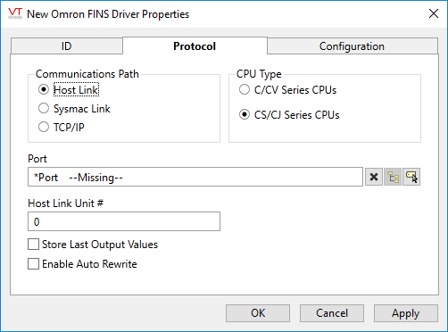

Omron FINS Driver properties Protocol tab
Connection Type
Choose which of the three available network types is being used by the system: Host Link, SYSMAC Link, or TCP/IP (i.e. SYSMAC Net Link).
CPU Type
The selection of CV Series CPU vs. CS/CJ Series CPU enables the driver to adjust for differences between these two types of Omron units.
Communications Port
Available only for Host Link and TCP/IP net-work types. In most cases, a COM port is used by Host Link while a TCP/IP port is required by the TCP/IP network type.
Host Link Unit #
Available only when a Host Link network is configured.
Store Last Output Value
If selected, the last output values sent to the Omron FINS device will be saved or stored. Use this option if you want to refresh the output values in the event of a communications failure or a power interruption.
Enable Auto Rewrite
If selected this box causes the last stored output values to be rewritten to the device in the event of a communications loss or power failure.

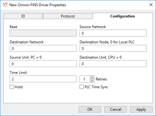

Omron FINS Driver properties Configuration tab
Base
Available only when the SYSMAC Link network protocol has been selected on the Protocol tab. Specifies the base address of the network support board in the workstation.
Destination Network
In a multi-network environment, use this option to specify by number, the network with which to communication. Set 0 for HostLink. The value is configured in the PLC for SYSMAC Link or SYSMAC NET, using the CX-Integrator.
Destination Node
Specify by number, which node on the network contains the PLCs with which you wish to communicate.
Destination Unit
Specify, by number, the PLC unit on the selected node with which you wish to communicate. The CPU is unit 0 while other rack-mounted cards are the unit number + 10.
Source Network
If you have a multi-network environment, specify by number, the network with which the workstation is connected. Set as for PLC network.
Source Unit
Specify by number, which node on the network contains the workstation.
Time Limit
Responses must be received within the specified time limit, otherwise a communications error will be assumed to have occurred.
Retries
Hold
PLC Time Sync
When selected, the workstation time is written to the PLC every hour.
