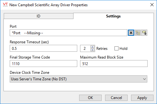

Campbell Scientific Array properties Settings tab
The Settings tab includes properties
Port
The port used to communicate with the data logger. The driver supports the use of directly-connected serial ports, modem-connected serial ports, TCP/IP ports and UDP/IP ports.
Response Timeout
This is the number of seconds the driver tag will wait for a response message from the device. If the driver does not receive a response within the defined length of time it will try again according to the following parameter.
Retries
Hold
Final Storage Time Code
Defines the final storage time format used when programming the data logger. Note that, if the devices is using multiple storage arrays, the driver expects all arrays to use the same format. The time code is defined as follows, where "x" is defined as "don’t care" and is normally entered as a 0:
- xxx1 Seconds (with resolution of 0.125 sec.)
- xx1x Hour-Minute
- xx2x Hour-Minute, 2400 instead of 0000
- x1xx Julian Day
- x2xx Julian Day, previous day during first minute of new day
- 1xxx Year
Any combination of Year, Day, Hour-Minute, and Seconds is possible (e.g., 1011: YEAR, Julian Day, Hour-Minute, Seconds).
Maximum Read Block Size
The maximum number of words that will be read from the site RTU on each transfer when retrieving logged data from a device using the "F" command. (Refer to the addressing section for more details.) Data transfers larger than this size require multiple read operations. Decreasing this value reduces the chance of communications errors by using smaller packets, but it will also increase the transmission time for large-record polls. Recommended values for this setting are 512 for direct serial and TCP/UDP connected devices and 128 or 256 for modem connected devices. If your connection is subject to system noise, you may want to use smaller settings to increase communication reliability.
Device Clock Time Zone
The time zone of the clock in the data logger. This is used to correct the time-stamped values read from the device by VTScada for storage in its historian using UTC format. Regardless of the time zone selected with this option, the driver assumes that the device does NOT adjust its clock for day-light savings time (DST).
- Uses Server Time Zone (no DST) - assumes that the device is in the same time zone as the server.
- Device Clock In UTC - the clock in the device is set to UTC.
- Actual Time Zone - select the actual time zone, in which the device is located.
