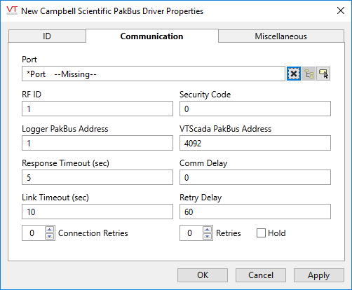

Campbell Scientific PakBus properties Communication tab
Port
The port used to communicate with the data logger. The driver supports the use of direct connected serial ports, modem connected serial ports, TCP/IP ports, UDP/IP ports, and PakBus RF Link tags.
RF ID
The RF ID is the identifier for the attached data radio on the RF network. This parameter is only used in conjunction with a PakBus RF Link tag and is ignored for serial or TCP/UDP connections.
Security Code
The security code that the logger will use. This value must match the setting defined in the data logger.
Logger PakBus Address
The PakBus address of the data logger. Each data logger that shares a common port tag must have a unique PakBus Address.
VTScada PakBus Address
The unique PakBus address assigned to VTScada on a PakBus network. By convention this value should be greater than 4000 and must not duplicate any other address on the network. The default is 4092.
Response Timeout (sec)
Determines how long the PakBus Driver will wait for a response from a data logger before reporting a communication error.
Comm Delay
Represents an additional delay expected for communicating on an RF network. When the PakBus Driver is connected to a PakBus RF Link tag, this value is used in building the network map that is transmitted by the base station. It is not used during direct communications with a serial or TCP/UDP port.
Link Timeout (sec)
Sets how long the PakBus Driver will wait before shutting down the PakBus link layer. This value should be set based on network performance, a typical range is between 3 and 10 seconds.
Connection Retries
This parameter sets the number of times that the PakBus Driver will attempt to per-form a poll. A poll will entail multiple messages, according to the configured number of retries.
Retries
Retry Delay (sec)
How long the PakBus driver will wait before retrying a poll.

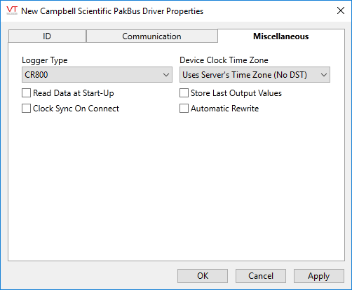

Campbell Scientific PakBus Driver - Miscellaneous tab
Logger Type
Defines the type of data logger the driver is communicating with.
Read Data at Start-Up
Select this option to force the driver to read the latest values from the data logger when starting VTScada.
Clock Sync On Connect
Select this option to automatically synch the clock in the data logger to the server’s time clock when a connection with the device is established.
Store Last Output Values
If this check box is selected the last output values sent to the PakBus device will be saved or stored. These can be used to refresh the output values in the event of a communications failure or a power interruption.
Enable Auto Rewrite
If selected this box causes the last stored output values to be rewritten to the device in the event of a communications loss or power failure.
Device Clock Time Zone
The time zone of the clock in the data logger. This is used to correct the time stamped readings read from the device by VTScada for storage in its historian in UTC format. Regardless of the time zone selected with this option, the driver assumes that the device does NOT adjust its clock for day-light savings time (DST).
- Uses Server Time Zone (no DST) - assumes that the device is in the same time zone as the server.
 - Device Clock In UTC - the clock in the device is set to UTC
 - Actual Time Zone - select the actual time zone that the device is located in
