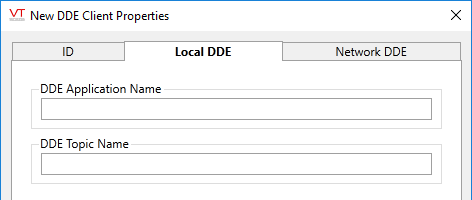

DDE Client properties Local DDE tab
The Local DDE tab of the DDE Client tag properties folder is used to set the application name for and a topic supported by the DDE server.
DDE Application Name
The DDE Application Name field enables you to enter the DDE program name. For example, "Excel".
DDE Topic Name
The DDE Topic Name field enables you to enter the name of a topic supported by the DDE server. If the application is Excel, this would be the name of the workbook file. For example: "MySpreadsheet.xlsx".

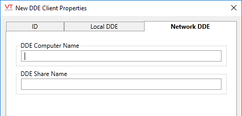

DDE Client properties Network DDE tab
The Network DDE tab of the DDE Client tag properties folder is used to set the name of the computer on which the DDE server is running, and the share name that identifies the DDE server on the computer.
DDEShare is based on NetDDE. For security reasons, Microsoft stopped distributing this product for versions of Windows following XP. If you choose, you may still be able to find and install NetDDE for your version of Windows. The instructions for doing so are beyond the scope of this document.
DDE Computer Name
The DDE Computer Name field enables you to enter the name of the server on which your DDE share (specified in the DDE Share Name field) was created (e.g. Station9).
DDE Share Name
The DDE Share Name field enables you to enter the name of the DDE share you created on the server specified in the DDE Computer Name field. You must add the .OLE extension to the name of the DDE share (e.g. DDEShare$.OLE).
