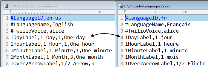

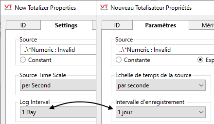

For example, anywhere that displays the English label "1 Day", actually uses the key "1DayLabel". This allows VTScada to translate the user interface to another language such as French.
English and French phrases for the VTScada user interface
1DayLabel as used in a Totalizer tag.

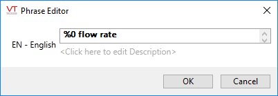

New phrases and phrase keys are created automatically whenever you save a new phrase, such as a new tag description or a new label on a page. Having created a new phrase, you can then use the Languages page in the Application Configuration dialog to search for the matching key. A more efficient way to create new phrases and keys is to work directly in the Languages page. An example follows:
- Open the Languages panel of the Application Configuration dialog.
- Ensure that the Key column is displayed.
Click the View button and select Key from the pop-up dialog if it is not. - Click the Insert button.
The Phrase Definitions dialog opens. - Click where indicated to add the new phrase.
- Place a %0 to mark the position for the first replaceable parameter. (%1 for the second, etc.)
- Click where indicated to add a description that will help translators know the meaning of the phrase.
- [Optional] If you have added another language to your application, create the phrase in that language now.
- Save the phrase.
Your new phrase should be selected in the list. It will not be saved until you click Apply, but do not click that button yet. - Click the copy tool, to the right of the phrase key.
The key shown here is an example. Yours will differ. - Use the key in the your expression.
If creating several phrases, it may be helpful to keep a text editor handy, copying phrases and keys to it as you create them. - Click Apply to save the new phrase and its key.
Because the list is sorted alphabetically by phrase or key, the new entry is unlikely to be visible on the screen after you click Apply.

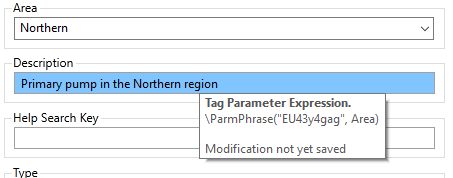

Example: A tag description that reflects the parent tag:
This is a relatively common task. You have a tag structure and would like the description of each child tag in each instance to identify which instance it belongs to. Perhaps (for example) you would like the description to read "Primary pump in the XX region" where XX should be the Area name for the tag.
Begin by opening the Language page in the Application Configuration dialog and creating the phrase, "Primary pump in the %0 region", as described earlier. For the sake of this example assume that the assigned key is named "EU43y4gag".
Create translations if required.
Open the tag's properties dialog and create an expression as shown:
"EU43y4gag" will not exist as a key in your application. A tag's Area is never translated.
