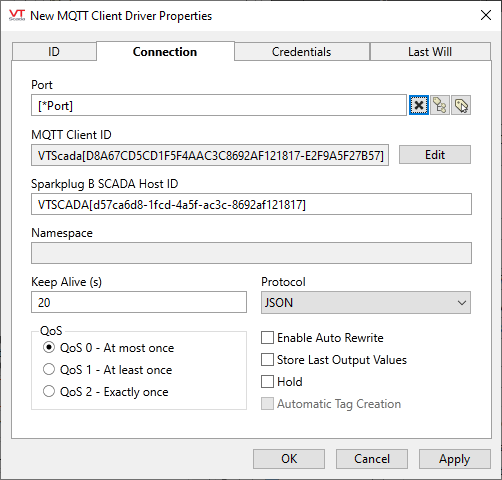

MQTT Client Driver properties Connection tab
Set the communication properties of the driver with the following fields:
Port
Select the TCP/IP Port tag that holds the address information for the MQTT data source.
MQTT data is available only over TCP/IP connections.
When configuring your TCP/IP tag, note that port 1883 is reserved with IANA for use with MQTT. Port 8883 is registered with IANA for use with MQTT over SSL. Your data source may use a different port.
This port must not be shared with any other clients.
MQTT Client ID
Every MQTT client must have a unique identifier. This is generated for you using the following four components to guarantee uniqueness on the broker as well as across VTScada applications and within the same application across multiple machines
- Either of a configuration property called "MQTTClientIDPrefix" if set (useful for branding) or the string "VTScada"
- The application's GUID (guaranteed unique identifier)
- The workstation's unique identifier
- This tag's name
The Client ID may be edited, but do so with caution and only when a broker requires a specific ClientID to allow a connection to be established. Typically, this value must be machine-specific, but that will not be the case after editing.
If a custom value has been set, the edit button is grayed out. To return to the default of a VTScada-specified Client ID, unique to the current machine, delete the parameter and apply the change.
Sparkplug B SCADA Host ID
This field is generated automatically and is common to all instances of the MQTT Client Driver in an application. The SCADA Host ID should be entered into the EoN configuration of the remote device, if supported by that device.
This parameter is editable, but do not change unless necessary. If it is edited in a redundant broker configuration, then all drivers that are part of the redundancy must use the same value for the parameter.
Namespace Parameter
Allows the Sparkplug B subscription to be limited to a specific namespace instead of the root spBv1.0/#. This may be required by some brokers, or it can be used to limit what data is requested by the driver. The subscription becomes spBv1.0/namespace/#.
Keep Alive
Specifies the number of seconds, after which the connection will close if no new data is received.
Ensure that the Disconnect Delay in your TCP/IP Port tag is greater than the Keep Alive time set here.
QoS
QoS stands for Quality of Service and specifies an agreement between the sender and receiver of a message. Zero is the lowest quality and should be used for reliable connections and where you do not mind if the occasional message is lost. Use QoS 1 when you need to be sure that every message is sent and you have a system in place to handle duplicate messages. QoS 2 is the most reliable but (due to its nature) the slowest option, ensuring that every message is delivered exactly once.
Protocol
Select from JSON, XML, Sparkplug B, Pass Through, or Custom.
It is possible to configure the driver with one protocol, but then have an IO tag use a different protocol by specifying another Decoder in its address. Be aware that you cannot do Sparkplug communications unless the driver protocol is set to Sparkplug. You can use other protocols when in Sparkplug mode by specifying a Decoder in the address.
Enable Auto Rewrite
Store Last Output Values
Hold
Select whether this driver should hold the last message received from the broker in the event of a communications failure.
Automatic Tag Creation Sparkplug B protocol only.
When selected, a hierarchy of Context and I/O tags will be created automatically under the driver tag whenever a BIRTH certificate is received.
After the tags are created, they can be modified as needed but should not be moved unless Automatic Tag Creation is disabled. Otherwise, new copies of the tags will be created in their place.
If using a Driver Multiplexer, refer to notes at the beginning of this topic for redundant broker setup. Ensure that automatic tag creation is OFF until you have finished driver configuration of both the MQTT driver and the Driver Multiplexer.

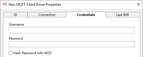

MQTT Client Driver properties Credentials tab
Use this tab to provide the user name and password if those are required to sign into the MQTT broker. (Not all brokers will require these.)
Username
The name required to sign in to the MQTT broker
Password
The password matching that user name. Passwords are never shown and are not stored in plain text. That said, security depends on ensuring that your link to the MQTT broker uses only a secure connection (TLS).
Hash Password with MD5
Select this option if the MQTT broker saves passwords using that algorithm. The password will be hashed before being sent to the broker.

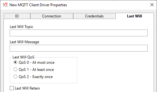

MQTT Client Driver properties Last Will tab
This provides a mechanism for the broker to notify interested clients that the VTScada client has disconnected. For example, if you set the Last Will Message to "VTScada MQTT Client 1 has disconnected" and the Last Will Topic to be "VTScada/Client/1", then if your application disconnects from the broker for any reason, the broker will send all clients that have subscribed to the topic "VTScada/Client/1" a message saying " VTScada MQTT Client 1 has disconnected "
Last Will Topic
The topic should be specific to the device, although this is not mandatory. One way to do this is to include the device name as part of the topic.
Last Will Message
The information to be sent to the topic in the event of a disconnection. "Offline" is typical.
Last Will QoS
Specify the quality of service with which the Last Will should be sent. (See notes in the description of the Connection tab.)
Last Will Retain
Use a retained message to update the status of a device on a topic. New clients will see the last retained message.
