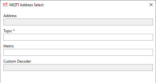

MQTT Address Assist dialog - manual mode
- For protocols other than Sparkplug, enter the Topic (required) and the Metric (optional unless in Sparkplug protocol).
- If your driver is configured for Custom protocol, enter the name of the custom encoder/decoder module (required).

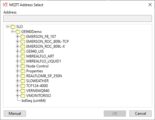

MQTT Address Assist dialog - Sparkplug B mode
When in Sparkplug B mode, you can Import Tags from PLCs rather than create and configure them one at a time.
- When the driver is in Sparkplug B mode, Topic, Metric and Custom Decoder will not be shown. Instead, the dialog will display a tree of addresses. This information is obtained from the BIRTH certificate.
If needed, the address assist can be made to switch back to the generic address entry mode using the "Manual" button, at the bottom left of the dialog when in Sparkplug B mode. (And, back to tree mode using the "Tree" button.)

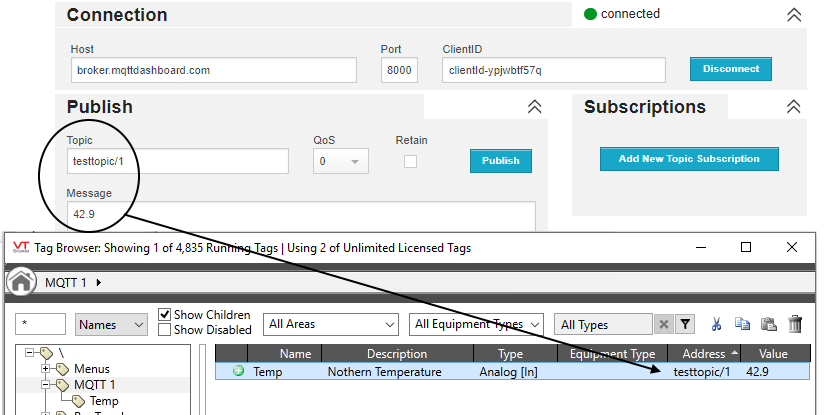

Read example, using the HiveMQ® public broker:
