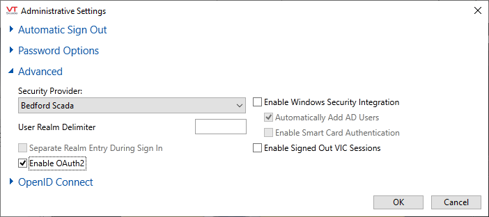

- Open the security Options dialog (Administrative Settings)
- Select the option, Enable OAuth 2.0, found within the Advanced section.
- Select OK to save your changes.
OAuth 2.0 enabled in the security Administrative Settings dialog.
- Close the Administrative Settings dialog.
The OAuth 2.0 Settings dialog option is now enabled.

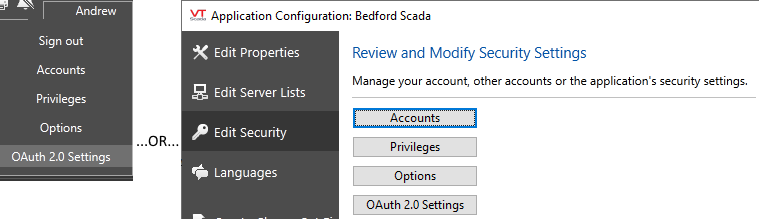

Available from either the drop-down security menu in the screen or the Security page of the Application Configuration dialog.

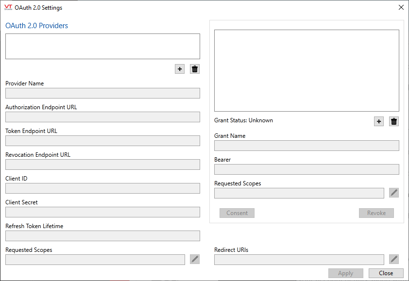

The OAuth 2.0 Settings dialog. All fields are disabled until you begin configuration of a provider.
Note that Providers and Grants can both be deleted using the trashcan buttons below the respective lists.
Grant Scopes and Redirect URI entries can be edited by double-clicking. Editing may require you to grant consent again.

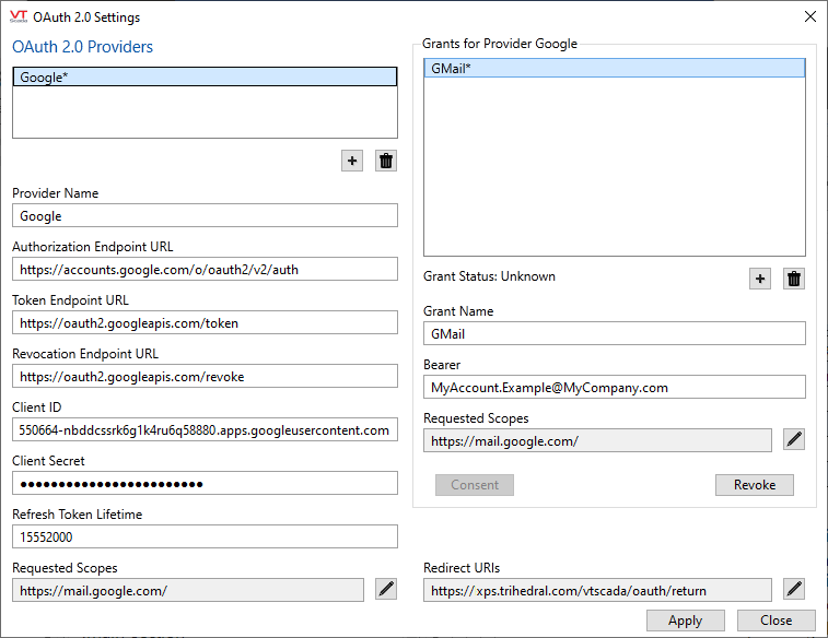

- Create a new Provider by clicking the
button under the providers list.
This enables the data entry fields. - Create a Provider Name as desired.
Create an easily recognized name to identify the purpose of the registration and the resource provider - Enter the Authorization Endpoint URL for your chosen OAuth 2.0 provider.
- Enter the Token Endpoint URL for your chosen OAuth 2.0 provider.
- Enter the Revocation Endpoint URL for your chosen OAuth 2.0 provider, if one exists.
- Set the Client ID and Client secret to the values created when configuring your OAuth 2.0 provider.
- Set the Refresh Token Lifetime to as appropriate.
This field is measured in seconds and must match the token lifetime used by your provider. This value refers to the time between uses of the refresh token, and not the overall lifetime of the token.
For reference, standard values from two commonly-used providers are:Google: 6 months of inactivity (15552000 seconds )
Microsoft: 2 weeks of inactivity (1209600 seconds )
- Select Pen icon next to the Provider Scopes field to open the Scope Editor.
- Enter the URI for the provider scope.

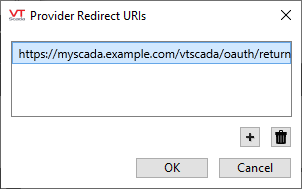

The scope is the service for which you are authorizing access. - Select the pen beside the Redirect URIs field to open the Redirect URIs editor.
- Set the OAuth Redirect URIs as given when configuring your OAuth 2.0 provider.
These will be the FQDN
Fully Qualified Domain Name's of your VTScada OAuth servers, along with the VTScada OAuth path which is "/vtscada/oauth/return".
Do not include any realm name for your application. Do not include the port number unless it is non-standard. - Create a new Grant by clicking the
button under the Grants List. - Create a name for the grant.
This is used to identify the service to which you are granting authorization. Naming the grant to match your provider's email service might be appropriate. - In the Grant Bearer field, enter the identification of the user who will be running the consent operation. Typically, this will be an email address.
This must be an email account registered with your provider. - Select the pen beside the Requested (Grant) Scopes field to open the Grant Scopes editor.
- Select the relevant email scope then click OK to close the dialog.
Scopes are the set of access permissions to be requested for the bearer. This must be a subset of those configured for the OAuth 2.0 provider registration.
This completes configuration. An example is shown following these steps.

Sample OAuth 2 Settings dialog, as configured for GSuite.

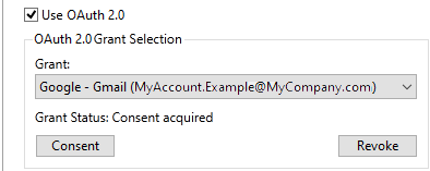

Grant Selection
If you configure more than one OAuth 2.0 grant, then you will have a selection of which to use within the Alarms tab of the Edit Properties / Application Configuration dialog. Outgoing and Incoming Alarm Email Acknowledgments will each have a Grant Selection.
To use:
Select the appropriate grant.
Initiate the consent operation for that grant.
Optionally, you can use this to revoke consent for a grant.

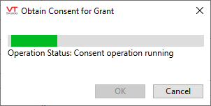

Your default browser is open, waiting for you to complete the operation there.
You must grant consent for VTScada to use an email account through your provider. The dialogs will vary according to your selected provider, but the process will be similar. First you must confirm the account to use. Then confirm that access is granted. Note that this operation will always happen within your default browser, not within VTScada.

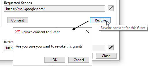

You may revoke consent for a grant at any time. Use the Revoke button and confirm that you wish to proceed.
