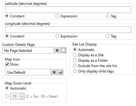

| Description: |
Parameter setting tool for Site List display options. While not part of the dialog library, and not starting with the letter "p", this is still classified as one of the PTools.
Example shows parameters for a site. This function works equally for a connector. |

| Parms | ||||||||||
| Required. A pointer to the array of parameters. | ||||||||||
| SiteDispIdxs | ||||||||||
Required. DispParmsStruct of site parameter indices. Invalid entries in this structure are assumed to be missing parameters. The corresponding control will be grayed out. This parameter is typically created as follows in your module initialization state. SiteDispIdxs = \DispParmsStruct(); SiteDispIdxs\Latitude = \#Latitude; SiteDispIdxs\Longitude = \#Longitude; SiteDispIdxs\CustomDetailsPage = \#CustomDetailsPage; SiteDispIdxs\CustomMapIcon = \#CustomMapIconParm; SiteDispIdxs\SiteListDisplay = \#SiteListDisplay; SiteDispIdxs\InitZoom = \#InitZoom; |
| SiteListOptions | ||||||||||
Required. A bitwise value controlling which Site List display options will be shown in the radio control.
| Trigger | ||||||||||
| Required Boolean. A trigger to indicate ongoing editing. | ||||||||||
| Reserved | ||||||||||
| Required but unused. Set to Invalid. | ||||||||||
| ParmsData | ||||||||||
| Required. An array of parameter data. One of the parameters to your configuration folder module. | ||||||||||
| OldParms | ||||||||||
| Required. An array of old parameters. One of the parameters to your configuration folder module. | ||||||||||
| OldParmsData | ||||||||||
| Required. An array of old parameter data. One of the parameters to your configuration folder module. | ||||||||||
| ParmsReady | ||||||||||
| Required. An array of "Ready" flags. One of the parameters to your configuration folder module. |
