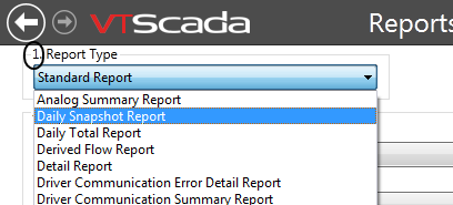

1. Select the type of report to create.
For the list of options, see: Report Types Described

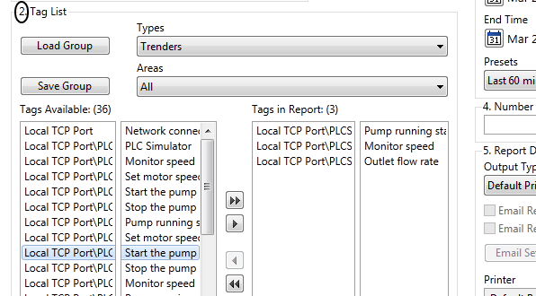

2. Select the tags to include.
The types of tag available for selection will be limited by your choice of report type. You can use the Areas selector to further filter the list.
Use the arrow buttons to move tags from the list of those available to the list of those selected.
This task is much easier if the tag selection is saved, to be loaded the next time the report is run.
After selecting tags, you should save the set as a named group, to avoid repeating work the next time that you run the report. Saved groups are required when creating Report Tags.
- Select the tags to be included by moving them from the Tags Available list to the Tags In Report list.
- Click the Save Group button.
The Select Group Name dialog opens.- Either type a descriptive name for the tag group in the Group name field, or select an existing group name to update with the new tag selection.
- Click OK.
Groups are saved to *.GRP files in your application's ReportGroups folder. They will be included in ChangeSets.
Load a Tag Group:
- Click the Load Group button on the Reports page.
The Select Group Name dialog opens.- Select the tag group you wish to load.
- Click on the down arrow in the Group Name area, or start typing the name of the group you want.
- Click OK.
The tags belonging to the tag group are placed in the Tags In Report list.
When you load a tag group, those tags replace any that were already in the "Tags In Report" list.
Sorting
Tags are sorted in alphabetic order, but you have the option to change the order as desired by deselecting the Sort Alphabetically option, then using the arrows to move selected tags up or down in the list.

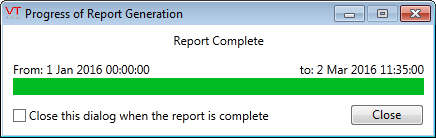

7. Click the Run button to generate the report.
A progress dialog will be shown while the report is being generated. In most cases, you will likely want to select the option, "Close this dialog when the report is complete" so that you do not need to close it after every report runs.
