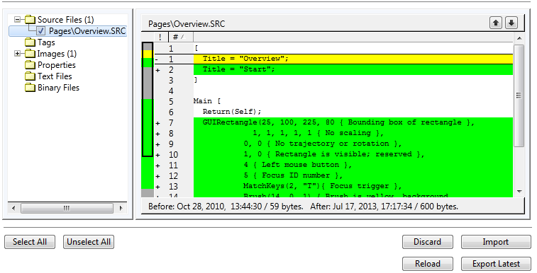

For source code and text files, you may review the changes, line by line before importing them. The new version of the line (in the file being imported) is marked in green and the old version (the current version in change control) is marked in yellow.

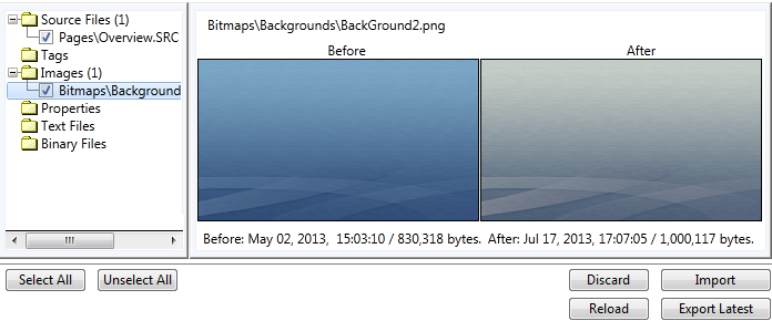

Image files are compared on a side-by-side basis.

  1. Expand the category to view the file(s).
  2. Click on the name of a file to examine. Changes are highlighted as shown at the beginning of this topic.
