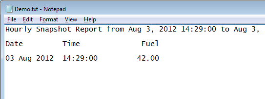

Text file
- Formatting is plain but easily read.
- Will be saved to a file on disk. You must provide the name and folder location for the file.
- May also be sent to an email address, either included in the body of the email, or as an attachment.
Sample text report

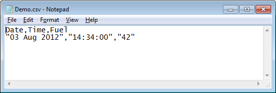

CSV file
- CSV = Comma Separated Values.
- The first row contains titles, remaining rows are enclosed in quotation marks and separated by commas. The formatting is designed to be imported into a spreadsheet or other program rather than read directly.
- May also be sent to an email address, as an attached file.
Sample csv report

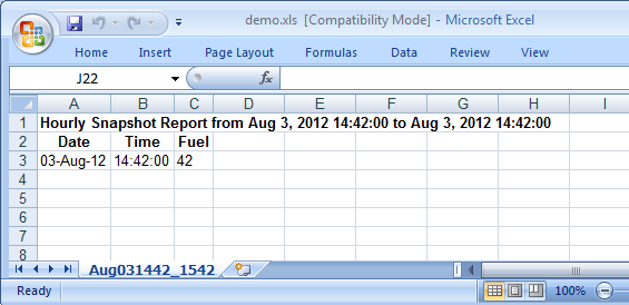

Formatted Excel™ spreadsheet file
- A header row is included in addition to the title row.
- Formatting consists of the header & title rows being displayed with a bold font.
- The worksheet will be named automatically using a timestamp.
Sample Excel report

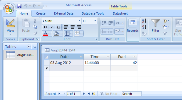

Access™ MDB database file
- The table name within the database is created automatically using a timestamp.
Sample Access report
