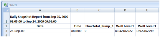

A daily snapshot report displays a "snapshot" of the value of each included tag, at the time you specify, on the dates you select.
When a daily snapshot report is generated, it contains a report header that identifies the report as a daily snapshot report, and indicates the duration or time period you configured for the report. For example, if at 2:00 pm you select a series of tags, set the time period to Last Week, and run the report, the daily snapshot report will display the value of each tag at 2:00 pm for the last 7 days.
The daily snapshot report will include:
- The date at which the data for each tag was read
- The time at which the data for each tag was read
- The subsequent columns provide a snapshot of the value for the tags you selected for inclusion in this report at the corresponding date and time
For example:

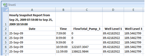

An hourly snapshot report displays a "snapshot" of the value of each included tag, repeated every 60 minutes within the time period you specify.
Information included in the report is as follows:
- The subsequent columns indicate a "snapshot" of the value for the tags you selected for inclusion in this report at the corresponding date and time
For example:
