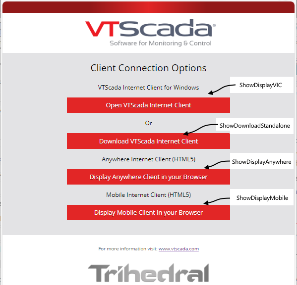

There are three ways to connect. Each of the clients has its own relative advantages. All allow operators to monitor and control the application. Users can identify which client they are using by looking at the  URL
 Uniform Resource Locator. The address of a web page..
- If the address ends with the word "Anywhere", then you are using the VTScada Anywhere Client. This will work on most devices and operating systems. The screens will be nearly identical to those at a VTScada run-time installation. (Connect Using the Anywhere Client)
 - If the address ends with the word "Mobile", then you are using the VTScada Mobile Client (MIC
 Mobile Internet Client.  Allows you to connect to a minimalized version of the application, suitable for mobile devices.). This has been optimized for use on mobile devices to minimize your connection charges. With the MIC, you have the option of switching to full display screens when needed, but most often you will probably prefer to use the optimized display. (Connect Using a Mobile Device) - Otherwise, you are using the VTScada Internet Client  (VIC
 VTScada Internet Client.  Allows you to connect to an application over the Internet with many of the features of a full VTScada workstation.). This uses a native Windows application that must be installed on your computer. This can be installed automatically through Internet Explorer's ActiveX capability (if permitted) or using the VTSX installer. (Connect Using the VTSX Program)

The VIC keeps a list of servers and will automatically connect to the next when the current server goes offline. Browser-based clients do not have this feature, but if connected internally and if the server goes offline, it will fail to the next. External connections from browser-based clients are limited by the network gateway.
Scenario 1. Session in progress
Applies to both the VIC and the Anywhere client. If the session has already started and a thin client is connected to a server that subsequently fails, the clients have an active server list and will fail over to the next active server in the list.
Scenario 2. New session
If the session has not already started and a Client tries to connect to an offline server, the VIC Client has the Server List cached and will connect to the next Active Server in the list.
An Anywhere Client will only attempt to connect to the server attached to the URL so will fail to connect. In this situation, you should create a second URL shortcut, specifying the backup server.
