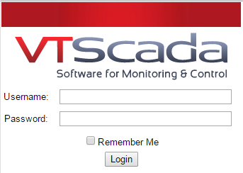

The Anywhere Client enables you to store your logon credentials temporarily using the Remember Me check box on the logon screen. This will remain in your browser's cache for the time specified by the application property, RememberLoginDuration. This defaults to 20160 minutes (14 days). You may choose to set this to 0, which will effectively prevents caching of credentials.
Of the three clients provided for VTScada, only the Anywhere client can be used with OpenID Connect Authentication. See also Domain Aliases (CORS)
The Anywhere Client logon screen, showing the Remember Me option.

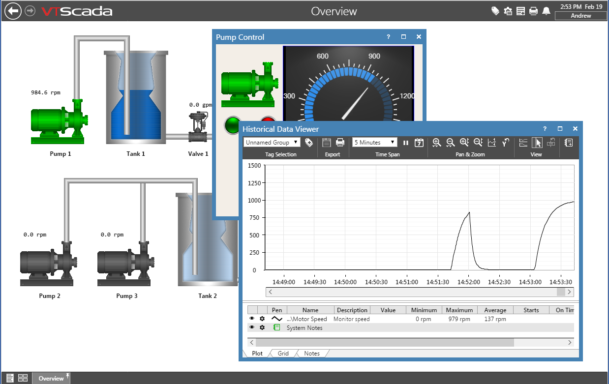

A sample application, with a pop-up window and a trend, running in Chrome using the Anywhere Client.
