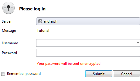

Upon establishing a connection, you will be prompted to log in:
MIC logon screen

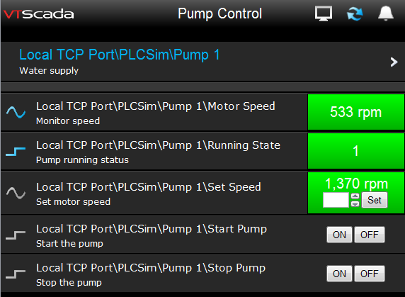

The mobile client will open. Note that the screen does not update continuously, but will refresh automatically based on the value set for the application propertyMobileBrowserAutoRefreshPeriod, which defaults to 60 seconds. A graphic display (actual page view) will refresh based on the property MobileBrowserSnapshotRefreshPeriod, which defaults to 600 seconds.
You can force the display to update at any time by touching the Refresh button. Note that each refresh of a graphic display may result in a significant amount of data being transferred to your device.

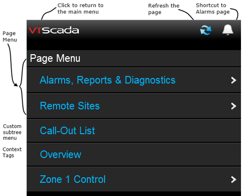

The MIC version of the page menu page
The word "Sites", found in the Remote Sites sub-menu, is controlled by the application property, ContainerTerm (ContainerTerm).
The alarm display of the Mobile Internet Client is limited to a maximum of the 100 most recent alarms and does not display alarms from previous days.
Realm Display Setup tags do not apply to mobile device connections.
