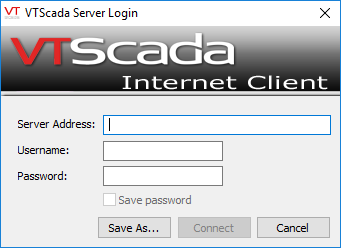

The VTScada Server Login dialog appears.
- Enter the Server address and realm name. The protocol portion, "HTTP://" is optional.
If using an SSL connection, you must use the protocol specification, "HTTPS://"
For example: https://vtsdemo.trihedral.com/exceldemo
- Enter the username and password for an account that has been granted the Thin Client Access privilege.
The Connect button will be enabled.
- Click on Connect.
