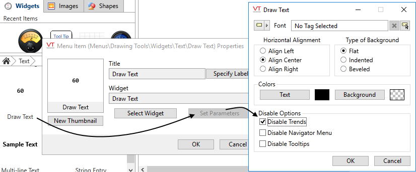

Disable operator interaction tools
Any of these tools can be disabled in any individual widget. The options will be available in the widget's properties dialog (detail shown).
Options vary by widget
These options are stored as parameters to the widget. This means that you can right-click to edit the widget's Menu Item tag in the Widgets palette to set defaults for these parameters. Note that any given widget may have more than one entry in the palette. A change to one Menu Item will not affect any other.
Right-click the palette entry to open the properties dialog.
