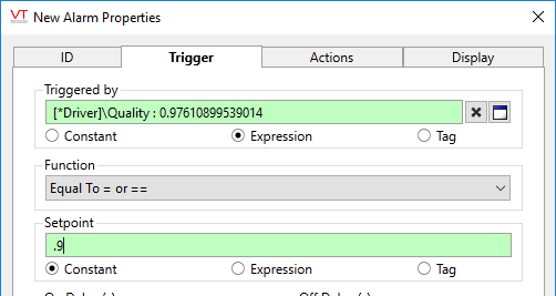

An alarm to warn of driver quality falling below 0.95.
Expression: [*Driver]\Quality
This expression assumes that the Alarm tag was created as the child of a driver. If the alarm cannot refer to a parent driver, substitute the full name of the driver tag for "*Driver".
Shown configured in an alarm tag:
