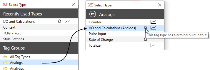

The Select Type dialog will open every(*) time you add a new tag. The last four types that you created will be listed at the top, making it easy to create another of these types. Below those, tags are grouped according to their use. Tags that have extra features are marked. You can hover the pointer over a symbol to learn more:
Selecting a type
(*) If you had set the Tag Browser's type filter to a specific tag type, then the selection part is done. When you add a new tag, the properties dialog will open for a new instance of the type that matches the filter. If the filter is set to a group, then the Select type dialog opens to that group.

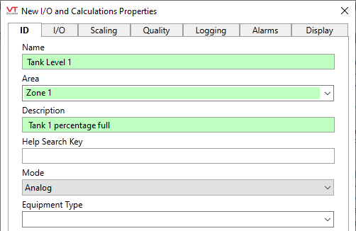

After you select a type, its properties dialog (aka "config folder") will open. Every tag's properties dialog has an ID tab, similar to the following image, which will include Name, Area and Description at a minimum.
ID tab of the I/O tag's config. folder

Fields turn green when you change the information within them. This helps you keep track of what you have changed and what you haven't touched. The green lasts only until you click OK. If you re-open the folder later, all fields will be white again until you start making new changes.
If you create a second tag of the same type, it will be pre-configured with the same values as the last except for the name, and those fields will be marked green so that you know which ones are not default values. This can save time, but be careful not to leave values that should have changed for the new tag. (There's a property to control that behavior:
