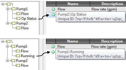

Rename a tag from "Pump1\Op Status" to "Pump1\Running".

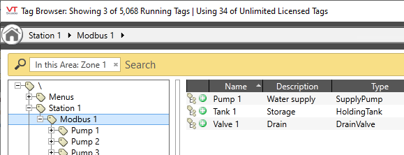

To move a tag:
- Select the tag to be moved, in the Tag Browser

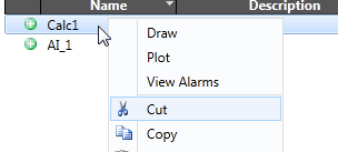

- Right-click on the tag and select Cut, or click the Cut button.
... or ...
- Right-click on a tag elsewhere in the hierarchy, under which you want to place the original tag.

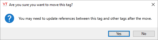

- Select Paste as Child
You will be reminded that references may need to be updated - see following notes on the effects of changing the name.
- Click Yes to acknowledge the message and complete the move, or No to cancel the move.

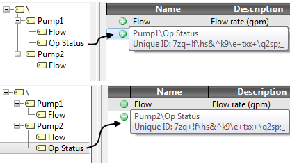

Move a tag from Pump1\Op Status" to "Pump2\Op Status".

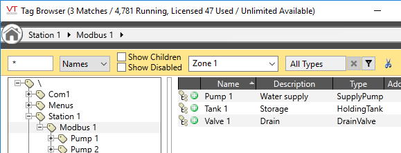

You have created a new type of tag, DrainValve. DrainValve was created using two tags: a parent Context tag (Valve1 in this example), and a child Analog Status tag named Flow. (See: Design Your Own Tags)
Sample tag structure with user-defined types.

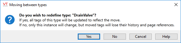

You move Flow from Valve1 into Pump 1 by doing a cut and paste operation.
When asked whether you want to redefine type ValveType, you decide upon "No".
Warning when moving a tag from a user-defined type.
If you choose "No" you cause the operation to be a cut (delete) and paste (create new tag) rather than a move. WaterPipe gets an Analog Status tag named Flow that is identical to the original, but which is a new tag with a new unique ID. Logged history, etc from the original Flow is now unrecoverable.
