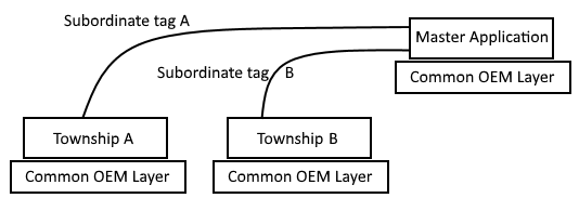

Township A and Township B are completely separate applications.
Master Application can monitor both.

    It is significantly easier to manage master and subordinate applications when they are all built on a common layer. In particular, this will eliminate the need to copy tag type definitions (and updates to same) from subordinate applications to master applications. It also reduces the likelihood of conflicts if subordinate applications contain custom tag types with the same name but differing definitions.

    • The recommended approach is to ensure that the master application and subordinate applications are based on a common OEM layer where those tag types and widgets are defined. This is by far the easiest method to use in terms of long-term maintenance.

  3. Create one Subordinate Application tag in the master application for each subordinate application.
