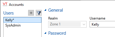

The account, Kelly, is being created by a manager who is a member of realm, Zone 1
There is no choice but to assign Kelly to the same realm.

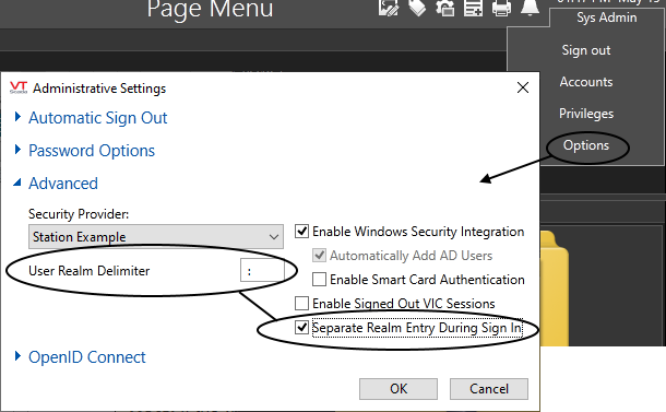

Security Realms are enabled by changing two application properties using the Administrative Settings dialog. (To open, select "Options" within the security menu.) You must have the Administrative privilege to open this dialog.
Enabling security realms with the standard delimiter, a semi-colon.
The realm delimiter must be a symbol (neither a letter or a number). While several symbols will work, you are advised to use a colon, which will serve reliably in all situations. You must define the realm delimiter before you can select the option of using separate realm-entry during sign in. Remember that it is necessary to press tab or enter after typing in a VTScada text field.
Do not use characters that could also be part of account names as the NameSpaceDelimiter. For example, a dot is typically part of an account name for any system using Windows Authentication.
While several characters are legal, you are strongly advised to use a colon, which will work dependably in all situations.
Within Settings.Dynamic, these properties are stored as:
- NameSpaceDelimiter= User Realm Delimiter.
- GroupLogin = Separate Realm Entry During Sign In

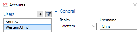

If using Windows Security Integrationand Security Realms, you must add the realm name and prefix to the account using the VTScada accounts dialog. (e.g. realm:username@company.com)
AutoAddADUsers cannot be enabled when a security realm delimiter is defined.
A realm user is one who is associated with a specific security realm. The Realm option is available only after completing the steps described earlier in this topic. (See NameSpaceDelimiter Property above). Realm names are stored as part of the user name, separated by the NameSpaceDelimiter character. (For example, Western:Chris)
When a realm user signs in, they will be prompted for their realm before they can enter their username. Superusers, who do not have a realm, can step past the realm field, leaving it blank.
