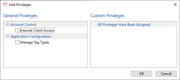

Use either dialog to add privileges to an account or to a role. The difference is in the information presented.
- Add is the most straightforward, but least informative. It shows a list of only the privileges that the account or role does not have. Select those that you want to add.

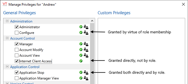

 - Manage also allows you to add privileges, but is far more informative after you know the symbols. All privileges are shown. Those that the account or role already has are marked according to how the privilege was assigned.
With the Manage dialog, you can remove privileges that were assigned directly, but not those granted by virtue of membership in a role.

The Manage Privileges dialog, as seen for an account that is
                    a Super User and also has the Thin Client Access privilege.
The following tools and symbols apply to the Manage dialog:
-  A selected check box to the left of the privilege name indicates that the privilege is granted directly.
You can select and deselect privileges here. - A green check mark indicates that the privilege is granted, either directly or by virtue of role membership.
This is an indicator, not a control. - A people symbol indicates that the privilege is granted by virtue of role membership.
You cannot change this using the Manage dialog.

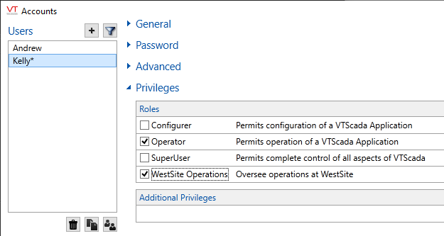

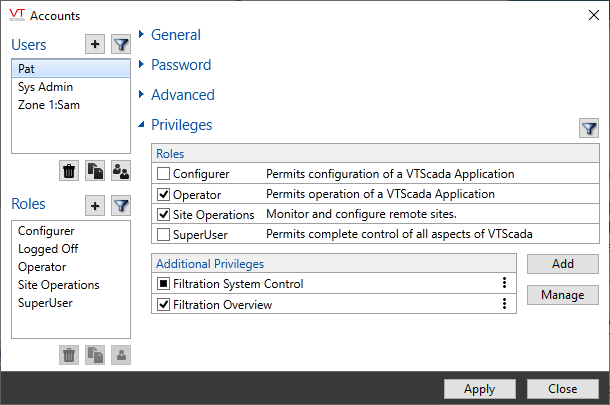

Assign roles to accounts:
- Create an account for each operator and developer at your site.
(See: Create Accounts and Roles) - For each account, select the roles matching the jobs that person will perform.
Assigning roles to an account.
