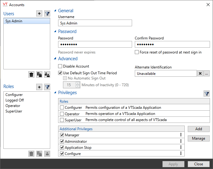

Use the Accounts dialog to create and manage all accounts and roles. Your account must have the Manager privilege. The following instructions are for creating an account, but apply identically to creating a role, excepting that roles do not have passwords, alternate identification or automatic sign off periods.
Reopen the Accounts Dialog (one of several ways)
Recommended practice is to assign privileges to roles, then assign roles to accounts.
The Accounts dialog. To open for the first time, click Sign In and choose to activate security.

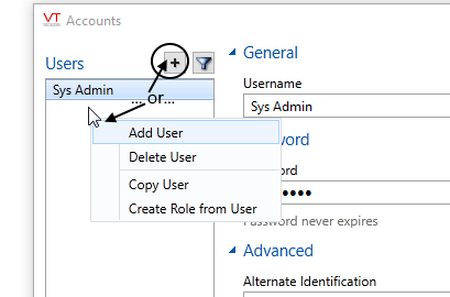

- Right-click in the list of accounts and select "Add User" or click the Plus button above the list of accounts.
The same tools are found in the Roles section, immediately below the Accounts section.
Either technique works to create a new account or role.

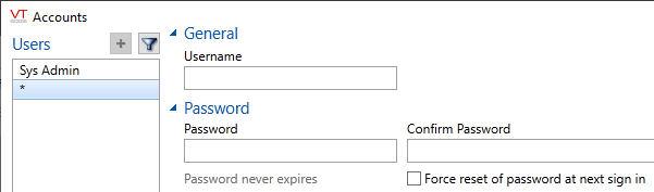

An asterisk appears, marking the place for the new account or role.
The asterisk is used to mark any account that has unsaved changes. You can switch between accounts to compare settings without losing changes made so far, and without losing track of which account has unsaved changes.
