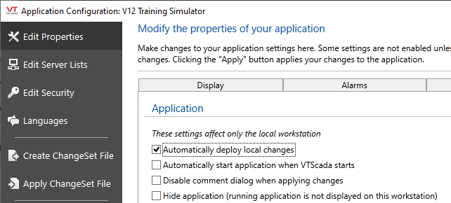

By default, all version changes are deployed automatically. This is controlled in the "Other" tab of the Edit Properties page of the Application Configuration dialog.
If you switch off the Automatically Deploy option, then you must choose when to deploy your changes, using the Deploy menu item in the Application Configuration dialog.  All local changes will be included when deploying.
You can use the Revert Changes tool only when there are local changes to revert. (That is, when the Automatically Deploy option is not selected.) The revert changes command will discard all local changes, returning your system to the last deployed version.
While automatic deploy is on, a variety of actions will cause deployment, including editing a tag, closing the Idea Studio, changing property settings, and more.

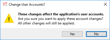

If a switch to a different version of the application will affect user accounts, you will see a warning, asking if account information should be changed. You can say "Yes" in response to this dialog to apply all changes including those that will affect account information.
Use care when changing versions
If you select "No" only the changes that do not affect user accounts will be applied.
Having selected "Yes" you can still recover those account changes. Do so by merging back in, those revisions in which the account changes were made.

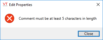

Comments are not mandatory in the default configuration of VTScada. If you prefer to make comments mandatory, you can change the minimum length required. To do so, add the application property RepositoryCommentMinLento the Layer section of your Settings.Dynamic file.
After setting a value for the property RepositoryCommentMinLen, users will see a dialog similar to the following if they do not provide the required number of characters.
Mandatory minimums on comments
