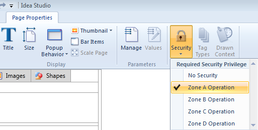

The label is used for display purposes, including the selection drop-down in each output tag's Merit tab and the security property of each page.
The number following the property sets its value, which is to be used in code. Note that this value is an offset from 16. Referring to the preceding example, where the page has been protected with the custom privilege "Zone A Operation", the first few lines of the source code of that page will look like the following:
Title = "Overview";
Color = "<FFFFFFFF>";
SecBit = 16;
PrivDes0, having number 0 in the list above, means that it's actual value to be used in code is 16 + 0 = 16.
