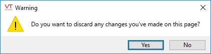

Unsaved Changes
If you make changes in the Application Configuration dialog, then navigate to a different page, or close the configuration window, you will see the following message.
Click Yes to discard the changes and continue navigating or No to retain the changes and continue working on the same page.
