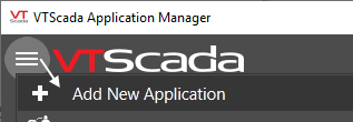

Use the Add Application Wizard whether you are creating a new application or adding an existing one to the VAM. Choices within the wizard will guide you through the process. You can start the wizard as shown in the following image of the VAM's toolbar. Full instructions are here: Add New Applications
Starting the Add Application Wizard

  1. Expand the main menu in the VAM.
  2. Select Add New Application.
