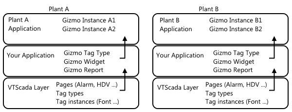

Perhaps in your application, you build a new tag type called The Gizmo for equipment unique to your industry. You also create a widget that represents all the I/O and alarms for The Gizmo. Further, you have created a report so that operators can view a daily summary of how The Gizmo performed yesterday.
You are using tools inherited from the VTScada layer to build new features in your application.
Two plants use The Gizmo brand hardware for their operations. Your application will be distributed to both plants to serve as the OEM layer for their applications. The applications at Plant A and Plant B also inherit all the features of the underlying VTScada layer, so they also have all the standard tags, widgets, reports, etc.
If the Gizmo manufacturing company adds a new feature, you will modify your application to incorporate that into your tag type, widget and report. You then send a Snapshot ChangeSet to both Plant A and Plant B, updating the OEM layer at each location. They can now install and use the latest Gizmo, without needing to do a thing to their applications. The changes were incorporated when they applied the ChangeSet to the OEM layer.

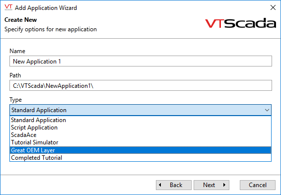

Any VTScada application can be used as the base layer ("type" or "OEM layer") for another. When creating every new VTScada application, a required step is to select its type. (The "Quick Add" option in the wizard simply sets the type to Standard Application, meaning the VTScada layer.) If, in the Add Application wizard, you select the Advanced option, and then New, you are given an opportunity to choose the layer that the new application will be built upon and inherit features from. It is possible to create a chain of many such layers, each inheriting the features of all the layers below it.
There is an exception to the rule: Script applications that you create cannot be used as OEM layers. Script applications are not built on top of other layers.
Select an OEM layer for a new app using the advanced option
