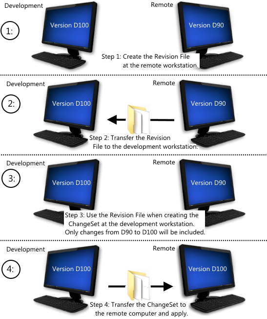

When sending updates for a larger application, it can become cumbersome to include the entire version history with each new update. You can limit a ChangeSet to include only the changes that are not already present on the target machine.
Revision files will typically be created on the workstation that the ChangeSet is destined for, not on the machine where the ChangeSet is being created. The point is to find out what's already at the destination before creating the set of changes required to bring that workstation up to date.
Another use is to create a revision file immediately after creating each ChangeSet. (Both are created on the same machine.) When the time comes to send updates to the remote machine, you can use the revision file dating from the last ChangeSet to include and send only changes made since the previous update.
VTScada will compare the version information of the remote computer, as contained within the revision file, to the local version log to choose what new revisions need to be included in the ChangeSet being created.
As a best practice, you should obtain an updated revision file from the remote computer immediately before generating a ChangeSet destined for that computer. The following example illustrates the process, where changes need to be transferred from a development workstation to a remote workstation. The steps would be the same, but on opposite computers if the transfer needed to go the other direction.
