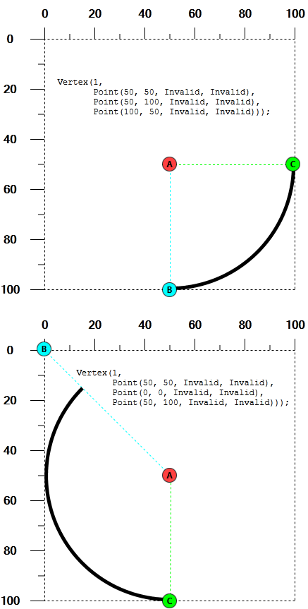

Required. Any expression that returns a Vertex value that describes this arc. The center point of the vertex is the center point of the arc. The two vertex handle points are used to find the start and end angle of the arc, by the angle each point makes with the center point. The vertex points defining the arc should be given in the following order: Refer to the example image in the comments section. |

Vertex Examples:
