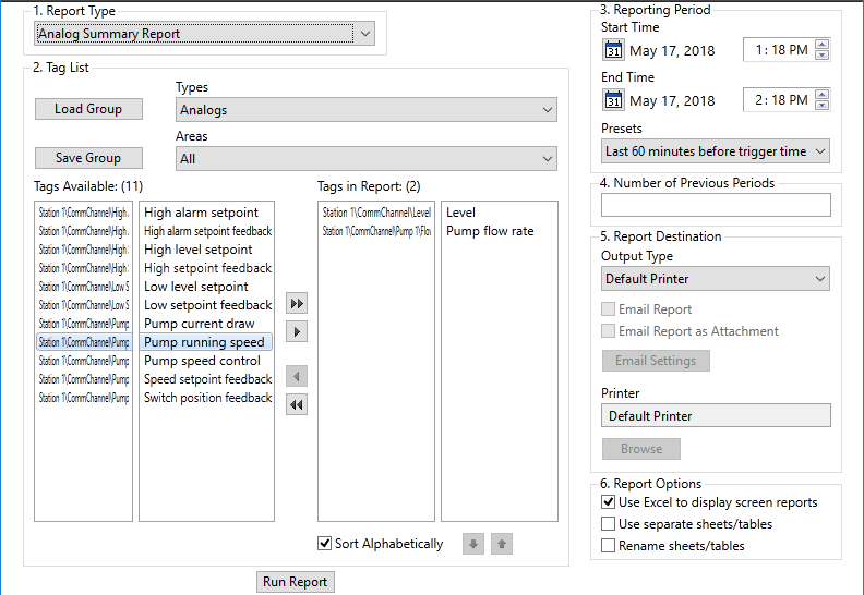

In general, you will create reports by stepping through the numbered sections.
1) Selection of report type.
2) Tag List. Filters and other tools for choosing the tags that will be reported on.
3) Reporting Period. Choose one of the predefined periods or use the controls to set a specific start and end time.

4) Number of consecutive periods. After setting a report period, you can generate a series of reports, each for the same length of time, but for consecutive periods extending back in time. For example, seven consecutive one-day reports rather than one seven-day report.
5) Report Destination. Select from ten options for where the report will be sent or displayed after it has been generated.

6) Other Report Options. Refinements that may be applied to some of the report destination choices.
The first option is to send a report to Excel, if available. The second and third options apply if previous periods are being generated (step 4) and the output is going to either Excel or Access format. Using separate sheets or tables for each iteration keeps the consecutive periods independent. If the Rename option is selected, you will be prompted for names when the report runs.
