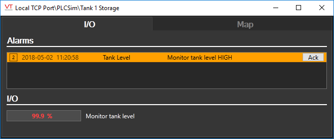

Variation for Site Pages:
The Site page for polling drivers, station tags, and other types will have alarm notifications. These will not look like the alarm page, but will show alarms and will include an Acknowledge button.
A site page alarm list
