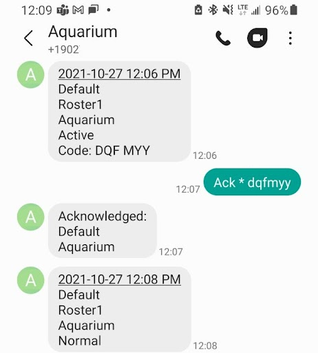

Configure for alarm acknowledgment by SMS text:
- Configure the Roster so that entries that send notifications by SMS text include the operator's security account username.
- [Optional] Ensure that AlarmNotifySMSAcknowledge is set to TRUE, to cause VTScada to send a follow-up text message, confirming that the alarm was acknowledged.
