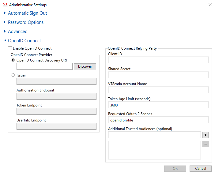

OpenID Configuration
All of the URLs configured in the OpenID Connect settings dialogue must be HTTPS, using a certificate trusted by the system running VTScada.
OpenID Connect is enabled and configured within the Administrative Settings dialog:
Enable OpenID Connect
You can choose to allow connections using OpenID Connect, standard VTScada username and password connections, or both.
If you disable both of OpenID Connect and remote sign-in using VTScada account credentials, users cannot connect through Internet or Mobile clients, remote data access (REST) or SOAP services.
Ensure that Enable OpenID Connect is selected before proceeding to the other options in this dialog.
OpenID Connect Provider
Enter the URI (Uniform Resource Indicator) to the metadata endpoint of your OpenID Connect provider. This will have a form similar to: https://your.provider.com/adfs/.well-known/openid-configuration (*)
After entering the URI, select the Discover button. The Issuer and Endpoint fields will be populated automatically from the information found there.
Alternatively, you may enter this information yourself, if known.
(*) "adfs" refers to Active Director Federation Services, provided by Microsoft. Your URI may vary.
Client ID
The Client ID that you have registered with your OpenID Connect provider for use with VTScada.
Shared Secret
The Shared Secret provided by the OpenID Connect provider for use with VTScada. Note that client certificates are not supported.
VTScada Account Name
Do not enter a VTScada Account Name.
This field specifies the claim that contains the VTScada account name and it will vary depending on how your OpenID Connect provider is configured. This may be "email", or "upn" etc.
Refer to the notes earlier in this discussion for more information about mapping OpenID Connect accounts to VTScada accounts.
Token Age Limit
Sets the maximum accepted age of tokens issued by the OpenID Connect provider.
Requested OAuth 2.0 Scopes
Scope is used to limit the authorization granted to the client by VTScada.
Additional Trusted Audiences
As part of the OpenID Connect process, you must check several things. One of these is that the token was issued for VTScada and is not one issued for another application and substituted in. This is done by the OpenID Connect Provider sending a list of audiences the token is intended for, and in some situations this can be a list of several audiences. VTScada must have a list of any other audiences that may be included in the ID token and any ID tokens received by VTScada that contain audiences not in this list will be rejected.
The entries added to the list are other Client IDs besides VTScada that are considered trustworthy.
This is unlikely to be required for most installations and may be left blank.
