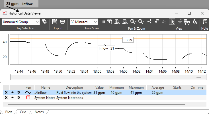

A popup window is displayed next to a widget. This window features a line plot displaying values from a tag named "Inflow" over the last 30 minutes.
Clicking a numeric display widget linked to an analog "Inflow" tag to open the HDV as a pop-up.

Broad graduations are displayed on the y-axis and x-axis for your estimation. The graduations along the x-axis represent increments of your selected Time Span. Unseen, VTScada has internally sliced the time span into about 300 to 1200 incremental 'points' and the values displayed at each point, as your drag your cursor across the plotted field, is representative of the average value during that sliver of time.
Why is it done this way?
For the Historical Data Viewer, VTScada is prioritizing readability and a plotted line that is as close as possible to its real-world analog. If you are viewing a week's history for a tag that is logged every 10 seconds, there are 60480 records in the log file for the week. It would be impractical and impossible to accurately represent 60480 points of real data along an x-axis that can fit on the average monitor. And so, the data is pooled and an average is given as the value for the time per point.
Conversely, in some VTScada configurations it is completely expected and acceptable for multiple points of time to pass before recording a new confirmed actual value. For digital tags, as long as all indications show an otherwise healthy and active connection, the last known value is repeated in the HDV for each point until new information becomes available. For analog tags, this begins in the same way but when a new value is given that indicates a change, the HDV will re-draw the plotted line to represent an analog slope from one confirmed value to the next. This is an interpolated value, and it is far more reflective of how analog changes occur in real time. Tanks fill, temperatures change, motors accelerate, and pH drops gradually, along a slope. Not in right-angled steps.

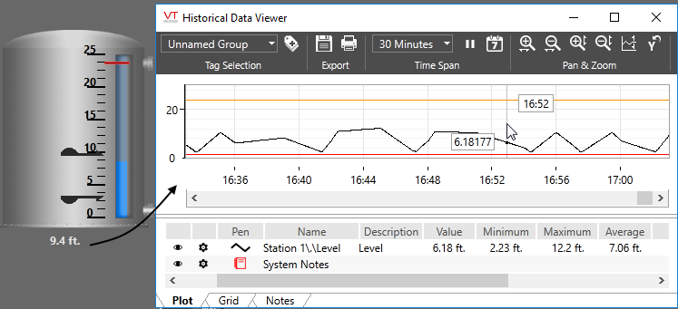

If the tag is being logged, the graph can be scrolled to show historical information. If there is no saved data, then the graph will show only new values as they are being collected. The HDV makes it clear whether the plot is of live (current) or of historical values. While you are viewing live data, the pause button (following image) will look like any other button. While you are viewing only historical data, the button will be an arrow on a yellow background. Ctrl + 0 or Ctrl + * will also resume live mode if the HDV is paused.
Controls to pause and resume live data display
The Pen Legend
The pen legend, across the lower edge of the window, provides a color-key to the plot lines, value statistics for the time span shown and controls to hide a plot line or change its display characteristics. The statistics shown are defined as follows:
  • Value - A calculated value. Hover over a plot line (or select a point) and see a value that is representative of the TPP.
  • Minimum - The smallest value recorded during the selected Time Span.
  • Maximum - The largest value recorded during the selected Time Span.
  • Average - The average of all values for a selected Time Span.
Some of the features and settings available in the HDV require you to select a pen from the pen legend. To access a Pen Properties dialog, double-click a pen or click the cog wheel icon.

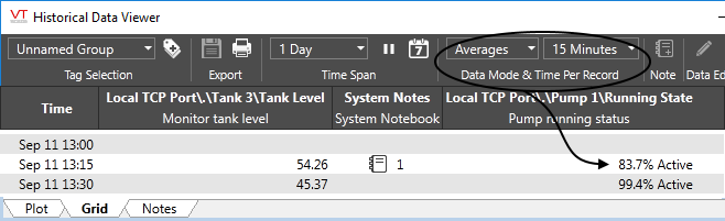

Analog Pens: Averages and Peaks
  • If the Plot Averages option is enabled, then averages will be plotted. If the Plot Peaks option is selected, then the minimum and the maximum values will be plotted, resulting in a banded plot. You can choose to plot Peaks and Averages at the same time. If neither is selected, no plot line will appear.
  • You can control the default scale range for analog pens. The scale can be set in the tag configuration, within the pen properties, or allowed to float, automatically adjusting to the currently displayed values.
Digital Pens: Percentages
  • In the legend, "Average" refers to the percentage of the displayed time for which the tag was in state 1 ("On"), expressed as a decimal value.
  • In the grid view, when viewing averages over a time span that is greater than the logging rate, a % active value will show you what percentage of the logged values within that time span had a value of 1.
Averaged digital values as percentage of their time in state 1.
To view the history of actual on and off cycles, select the Raw Data option from the menu.
