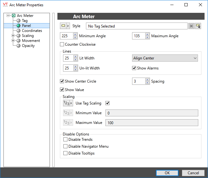

The properties dialog for the Arc widget:
Optionally, select a Style Settings tag to control the colors shown by the arc, in response to the linked tag's value and alarm state.
Minimum Angle & Maximum Angle
Sets the starting point and the ending point for the sweep of the arc. Defaults to 270 degrees for the start angle and 90 degrees for the end angle. The angle is measured in degrees, and increases in the clockwise direction.
Example (b) shows an arc with minimum angle zero and maximum angle of 180 degrees.
Lines
Use to adjust the width of the unlit (background) and lit (foreground) portion of the arc.
Example (c) shows an arc with an unlit width of 18 pixels and a lit width of 8 pixels. The alignment is Center. Alignment applies only when the lit and unlit widths are of differing values, giving you the option of aligning the lit portion against the outside edge, inside edge, or centered within the unlit portion.
Show Alarms
If selected, the arc will indicate when the associated tag is in an active alarm state by using the alarm indication settings as configured in the associated Style Settings tag. Only that portion of the sweep above or below the alarm setpoint will use the alarm indication.
This option is in use for all four of the example images.
Counter Clockwise
If selected, sections of the arc will sweep (increase) in a counter-clockwise direction rather than the standard clockwise.
Show Center Circle & Spacing
These two properties should be used together. The center circle will be displayed using the unlit color of the arc. The spacing controls the size of the circle by setting the number of pixels from the unlit ring of the arc to the perimeter of the circle.
Example (c) shows a center circle in addition to showing lines with varying widths.
Show Value
If selected, the arc will display the current value of the linked tag. Units are not shown.The color will always match that of the lit portion of the arc.If a center circle is shown, then the value will be superimposed on the circle.
If Use Tag Scaling is selected, the minimum and maximum range of the meter will be controlled by the tag's scaled minimum and maximum values.
Otherwise, you can override those values to set your own scale range. For example, assume that you have a tag for which the minimum and maximum scaled process values are 20 and 80 respectively. Drawing this tag with a minimum value of 0 and a maximum value of 100 will result in a meter that shows a full range of numbers from 0 to 100, but whose needle will move only between 20 and 80.
