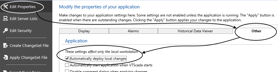

To toggle the Auto-Deploy Setting:
- Open the Application Configuration dialog.
 - Select the tab labeled "Other".
 - Select or deselect the Automatically Deploy check box.
- Click Apply.

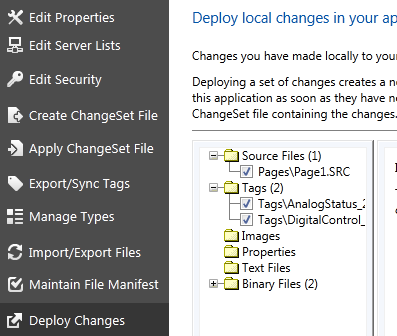

Local changes can be deployed while you are working in the Idea Studio. Click the button provided in the title bar of the studio:
Deploy from the Idea Studio
A more powerful tool for deploying changes can be found in the Application Configuration dialog:
You can open this page as follows:
 - Click on "Deploy Changes" from the menu.
All changed files are listed

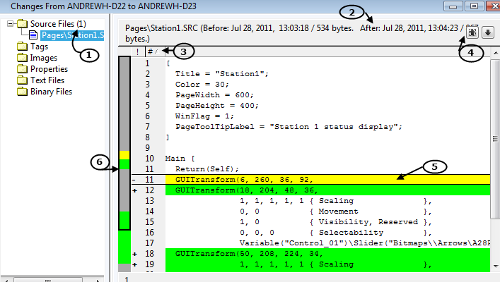

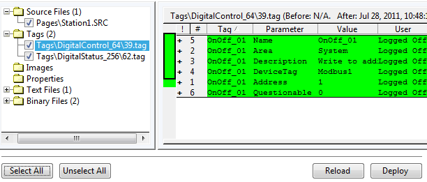

Use the Deploy Changes screen to see exactly what was done to each source file and tag. For example, clicking on the Analog Control tag (shown in the previous image) will open a display showing what was done to configure this tag:
Every change to every parameter is shown
Changes made to source code such as a page, will show green lines for what is new, and yellow for the previous values. (Circled numbers link to descriptions in the following text.)
Numbers refer to the following list
The following tools are available to help you work with this display:
(1) The number of changed files in each category is shown in parentheses.
(2) Before and after time stamp and file size.
(3) Columns can be sorted by type of change (addition + or removal -), line number, alphabetic.
(4) Move Next and Move Previous changes the focus box (5) from one change to the next.
(6) Changes throughout the file are shown in color bars on the side panel. The black rectangle shows how much of the file is visible and can be dragged to show the next change.
When you first open the Deploy Changes page, all changed items will be selected. By selecting individual items in the list and using the buttons at the bottom of the page, you can choose which changed items will be included when you click the Deploy Changes button.
Available command buttons
The Reload button will refresh the display. If you have made local changes while the Deploy Changes page was open, click this button to ensure that all changes are displayed before deploying.
