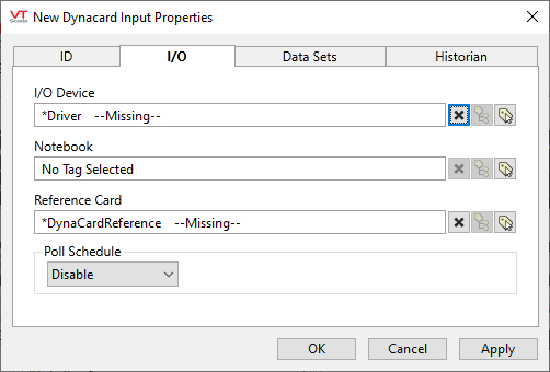

Dynacard Input properties I/O tab
I/O Device
The Dynacard Upload Driver Tag that reads the data collected by this tag.
Notebook
If you intend to allow operators to add notes to the Dynacard graph, you must select the Notebook Tags that they will use.
Reference Card
The Dynacard Reference Tag that may be used to store copies of this tag's Dynacard graphs that you would like to be able to view easily at a later time.
Poll Schedule
Determines the times at which the driver will poll the POC for this Dynacard's data.
