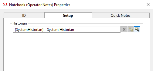

Historian
If an Historian tag is selected, this tag's run-time values will be saved for use in reports and the Historical Data Viewer. Historian configuration and advanced logging options are described in the discussion of the Historian Tags.
If your goal is to disable logging, set the Enable parameter (below) to 0 rather than deleting the Historian parameter.
There are consequences if you change the selected Historian tag after you have begun collecting data. If you switch to a new Historian (perhaps for organizational or load sharing purposes), the data collected for this tag by the previous Historian will become inaccessible. Historian selection and configuration should be done during the project design stage.

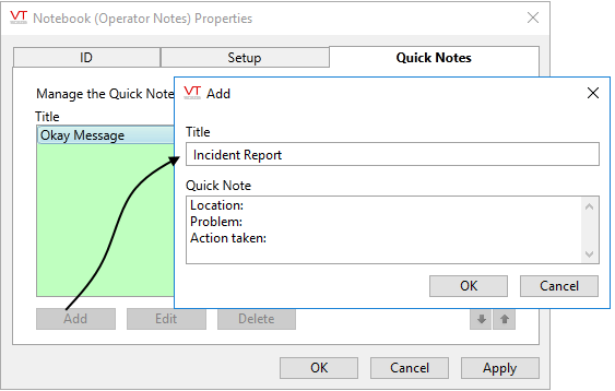

Notebook properties Quick Notes
Use this tab to create pre-written phrases that can be added to new Operator notes with a click. Each Notebook tag will maintain its own list of Quick Notes.
These can be templates with blanks for operators to fill in, or they can be often-used phrases or keywords to be used later when searching (example: [MAINTENANCE]).
By using a template, you ensure that information is organized in a consistent form within notes and that no details are forgotten. By providing often-used phrases, you can help operators by saving them the time they would otherwise spend typing the same phrase each time it's needed.
When operators add a Quick Note to a new note that they are writing, the text is copied to their editing field. No link is maintained between the Quick Note and the final version of the note that the operator saves.
Add a Quick Note by clicking the Add button. Provide a title, which will be visible to operators when adding notes, and the text of the note.
You may add, edit or delete Quick Notes at any time. No link is maintained between a Quick Note and a saved operator note, therefore the work that you do here has no effect on saved notes.
